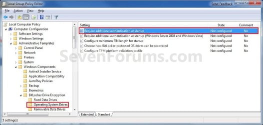

1. Open the Local Group Policy Editor.
2. In the left pane, click on to expand Computer Configuration, Administrative Templates, Windows Components, BitLocker Drive Encryption, and Operating System Drives. (See screenshot below)
3. In the right pane, right click on Require additional authentification at startup and click on Edit. (See screenshot above)

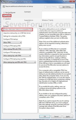

4. To Allow BitLocker without TPM
A) Select (dot) Enabled. (See screenshot below step 6)
B) Under the Options section, check the Allow Bitlocker without a compatible TPM box. (See screenshot below step 6)
C) Go to step 6.

B) Select (dot) either Not Configured or Disabled. (See screenshot below step 6)
6. Click on OK. (See screenshot below)

8. Open the Start menu, and type gpupdate.exe /force into the search line and press Enter. (See screenshot below)
9. You will see this command prompt pop-up briefly, then go away when completey successfully. (See screenshot below)
10. If you did step 4, then go to OPTION ONE to turn on BitLocker. If you did step 5, then you are done.

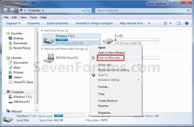

3. Open the Start menu and click on the Computer button, then right click on the Windows 7 or other operating system drive or partition letter and click on Turn on BitLocker. (See screenshot below)
A) Go to step 5.

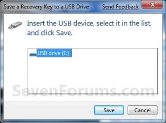

6. Select the USB flash drive from step 2, and click on the Save button. (See screenshot below)
7. Select the Save the recovery key to a USB flash drive option. (See screenshot below)
NOTE: It is highly recommended that you do the other two options as well and save this key file somewhere safe. You will need the recovery key number to gain access to the encrypted Windows 7 or other operating system drive if you should lose or damage the USB flash drive with the startup key, or if BitLocker locks the drive.
A) Select the USB flash drive from step 2, and click on the Save button. (See screenshot below)

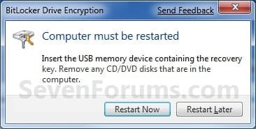

8. Check the Run BitLocker system check box, then click on the Continue button. (See screenshot below)
9. Click on the Restart Now button. (See screenshot below)
WARNING: This will restart your computer immediately. Close and save anything that you are working on first.

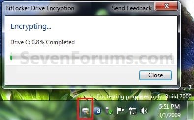

10. When the computer restarts, BitLocker will start encrypting the Windows 7 drive. Click on the BitLocker icon in the taskbar notification area (far right) to see the encryption status. (See screenshot below)
NOTE: This may take a while to finish.
11. When BitLocker is finished, click on the Close button. (See screenshot below)

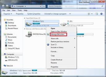

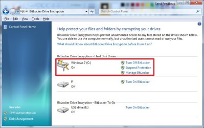

12. You will now have a Manage BitLocker option in the Control Panel and Computer for the encrypted drive. (See screenshots below)
13. If you click on Manage BitLocker, these will be the options that you will have below. (See screenshot below)

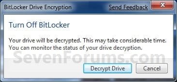

OPTION TWO
Turn Off BitLocker to Decrypt Windows 7 Drive
NOTE: If you do not care about losing all data on the drive/partition, then formating or using the clean command will allso turn off BitLocker for the drive/partition.
1. Open the Control Panel (icons view), and click on the BitLocker Drive Encryption icon.
2. Click on Turn Off BitLocker for the Windows 7 or other operating system drive or partition letter that you want to turn off BitLocker with. (See screenshot below)
3. Click on the Decrypt Drive button. (See screenshot below)

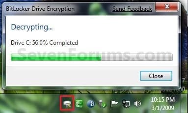

4. BitLocker will now start decrypting the drive. Click on the BitLocker icon in the taskbar notification area (far right) to see the encryption status. (See screenshot below)
5. When finished, click on the Close button. (See screenshot below)
