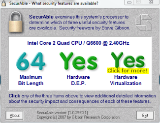

Just as a point of reference, this is what I see when I run Securable from inside Vista x64 or Win7 x64:

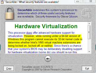

Hardware Virtualization
This processor does offer advanced hardware support for virtualization. However, while running under a 64-bit version of Windows this program cannot execute its 32-bit kernel code to determine whether Intel's VMX virtual machine extensions are being locked on, locked off, or neither. Since there's a chance that your system's BIOS may be deliberately disabling support for hardware virtualization (some do) you should re-run this program, if possible, with administrative privileges under a 32-bit version of NT, XP, or Vista. That will allow SecurAble to run a bit of kernel-mode code in order to determine exactly what's going on. (Note that you can also poke around in your system's BIOS to see whether you're able to find any references to "hardware virtualization" or "VMX", etc.
If you want to test your system's true support (and this may only be needed for those running Intel CPUs on nVidia-chipset based motherboards, but it is helpful to know either way) take a gander at this file:
View attachment vt.zip
It's small, and it is an ISO - you can probably extract the contents (or else use a virtual CD tool and mount it) and make a bootable UFD and save a platter, but I have so many TDK CD-RWs here that I recycled one of my older WinXP Norton Ghost backups....
Enjoy.
