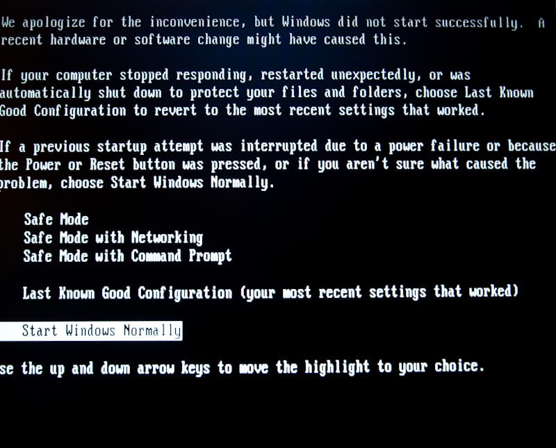

I’ve uploaded an image of the screen I end up at, but only if there is a bootable CD (i.e., xp) in the drive and I don’t press “any key” (to boot from CD). It will ‘loop boot’ to this window (when it times out) Otherwise (no CD in drive) I end up at: Boot Failure. System Halted.

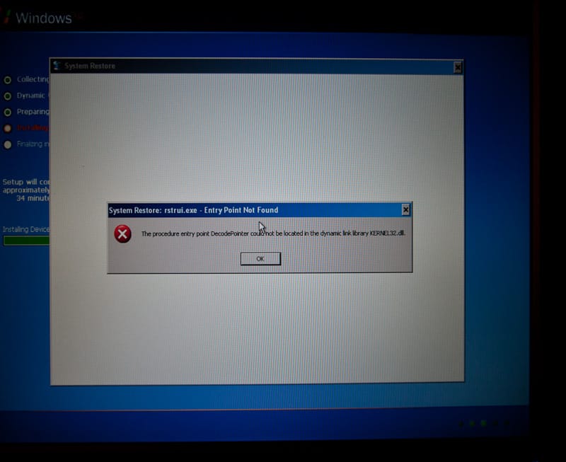

More info: I tried doing a repair install, but was stopped at 34 mins remaining (twice) with this error:
It appears that system restore is the issue and is somehow preventing the machine from booting into _any_ mode.
