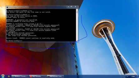

Ive already tried repair computer but says it cant be done on this operating system
this is what i got when i ran command prompt

27 Jul 2009   #6
Quote   Quote: Originally Posted by Gilly View Post
theres a error in your LPT port or LPT not found.
HDTP v2.6 could not fix this problem.
contact your local repair shop
Hi Gilly,
LPT is the printer port found at the back of your machine
It has nothing todo with chkdsk canceling its scan of your hard-drive, first lets open an elevated cmd prompt by typing cmd into the start-menu searchbox then right-clicking and selecting "Run As Administrator"
From there enter: fsutil dirty set C: then enter chkdsk C: /F /V
Once you have entered the chkdsk command you should see the following:
Chkdsk cannot run because the volume is in use by another
process. Would you like to schedule this volume to be
checked the next time the system restarts? (Y/N)
Press Y then Enter, from there you will see:
This volume will be checked the next time the system restarts.
That should force chkdsk into running a complete scan of your drive once you reboot, let us know the results
Steven
