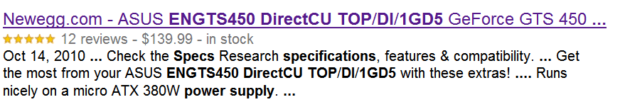

In the mean time I've going to order a new card, and decided on the GTS 450. According to Nvidia it has a minium of 400w PSU, mine is 430w. HD 5750s minium is 450, so is the GTS 250 for that matter.
I've picked the Asus ENGTS450 DirectCU TOP/DI/1GD5 from Newegg, as it has good reviews (though only 11). I was trying to double check its PSU reqs, but I havent found any besides what Nvidia says about the GTS 450.

Well from the pictures it requires a 6pin connector so I think your right on the minimum.
I did manage to find this

Kools thanks thefabe :) .. hopefully my Antec Earthwatts 430 should work with the GTS 450 and install the 2nd HDD.

Your Welcome.Yet we still know it's really about the Amps on the 12+ rail(s)

Hopefully my +12v 17a & 16a rails will support the GTS 450 and the 2nd HDD.
