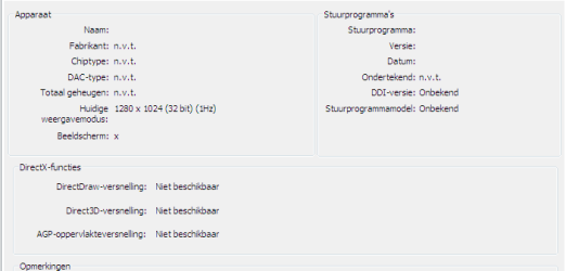

Hello i just installed Windows 7 RC. but now i have a problem my graphic card is not recognized . The weird thing is i hooked up my graphic card to my pc and monitor and that works . i tried to update the driver 186.18 that is windows 7 compatible but it says "The NVIDIA Setup program could not locate any drivers that are compatible with your current hardware. Setup will now exit." Also i got no other drivers installed. I hope i get a solution .

Thanks for the reply , i downloaded the 32-bit version .
Operating System: Windows 7 Ultimate 32-bit (6.1, Build 7100) (7100.winmain_win7rc.090421-1700)
Language: Dutch (Regional Setting: Dutch)
System Manufacturer: System manufacturer
System Model: System Product Name
BIOS: Phoenix - AwardBIOS v6.00PG
Processor: AMD Athlon(tm) 64 X2 Dual Core Processor 4400+ (2 CPUs), ~2.3GHz
Memory: 2048MB RAM
Available OS Memory: 2046MB RAM

i dont know wich device it is in the device manager because it's not named nvidia graphic card or something.

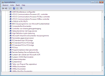

do you have any UNKNOWN devices that have yellow triangles on them. could you use the snipping tool to take a snapshot of device manager and upload it for us to see??

"This device cannont find enough free resources that it can use. (Code 12)
If you want to use this device, you will need to disable one of the other devices on this system.
(in english lol ).

i also tried to update that one but it failed.

Me trying to read your language is worse than you trying mine. The code 12 is explained here Code 12: This device cannot find enough free resources that it can use
basically it meanstwo device are configured to use the same port, irq, or other resource. if you change one they both will work

I have a feeling that it is not loading required motherboard / chipset drivers that will allow the OS to recognize PCI devices...hence it is not even seeing the graphics card for anything other than a standard VGA device....
Check to see if you can find updated (meaning 7 compatible / specific) drivers for your motherboard....

Any and all that you can find that will work in Vista / Windows 7.
Most likely it is chipset related, but I would see what ASUS has to offer in terms of updates - even look for BIOS updates as well....
