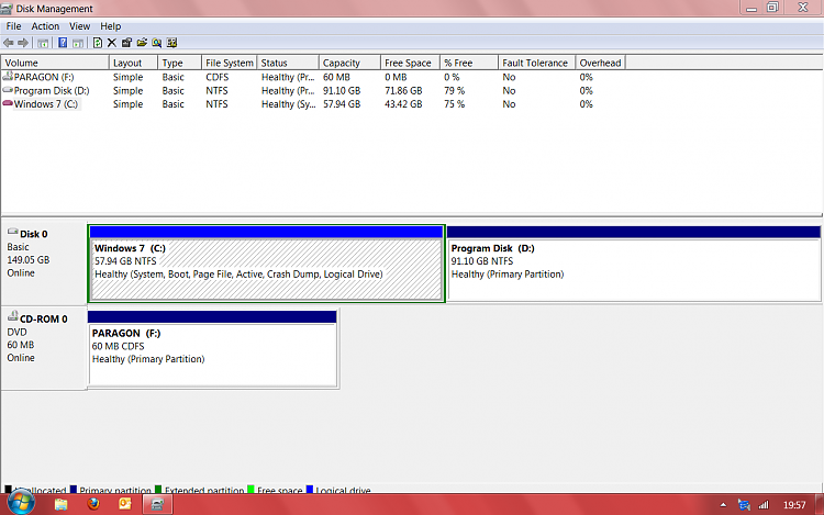

Use the Paragon disk to boot into Win7, then post back a screenshot of your maximized full Disk Management drive map with listings, using Snipping Tool in Start Menu.
Here is a screenshot, thanks for your help.

The drive APPEARS to be missing the 100MB boot partition.

The problem is that you've reimaged to a Logical partition from which Win7 cannot boot. It must have originally been on a Primary partition since the reimaged partition contains the "System Active" boot files, but they nevertheless can not start from a Logical partition now.
The solution to this is to burn to a free Partition Wizard bootable CD, boot it, rightclick on Win7 partition to Modify>Convert to Primary, click OK.
Next highlight the WIn7 disk itself on the map, from Disk tab choose Rebuild MBR, click OK. Now Apply all Steps.
Now reboot into Win7 to see if it will start. If not boot the Win7 DVD or Repair CD to run Startup Repair a few times to repair or rewrite the System Boot files to Win7 partition, reconfirming first that it is Primary and marked Active.

OK, got it sorted.
Using Paragon in Windows 7, it allowed the change to Primary, and then rebooted.
Now boots straight in to 7.

The fact that the DISKMGMT screenshot shows no "system reserved" partition, which would be "primary" and "active" suggests you did not use Win7 and a "system image".
Also, the screenshot show that your new C partition on the new hard drive is "logical", which is not the way it was originally on the old drive. So again, this could not have been the result of using a Win7 "system image" to recover from.
Now the fact that the C-partition is "logical", and the fact that you're missing the "system reserved" 100MB partition in which the boot manager files are located (and were located on your original hard drive)... this all indicates that your "restored from regular backup" process is flawed.
The fact that Partition Wizard shows this drive as "unallocated" is yet another issue, and actually would be very helpful to the author of Partition Wizard as a "laboratory rat" so this bug can be chased down and fixed. It's not the first time it has been reported. I'm of the opinion that whatever program you used to "restore from regular backup" is at fault here (or maybe it's the type of "regular backups" you were doing that really wasn't suitable for this type of new-drive transplant).
I suspect "system image" would have been a better choice for recovery to the new hard drive (if you had a "system image" to recover from), but unless you provide details about your backup/restore program and procedure this is still pretty mystifying.
Anyway, your current Win7 drive which shows no "system reserved" primary partition as "active", but instead shows C as a "logical" and "active" partition... well, that's not right. Actually Win7 can be installed onto a "logical" partition (though by default it goes onto a "primary" partition), but the problem really is the missing boot manager files and the "system reserved" partition where they lived.
