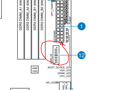

Do you have your USB 3.0 connected to this connector on your motherboard? Red USB 3.0 motherboard .
connector? Blue connector typically comes from front panel.

Yes, they are both connected. They all worked 2 weeks ago before I had my latest BSOD issue to which I had posted here.
