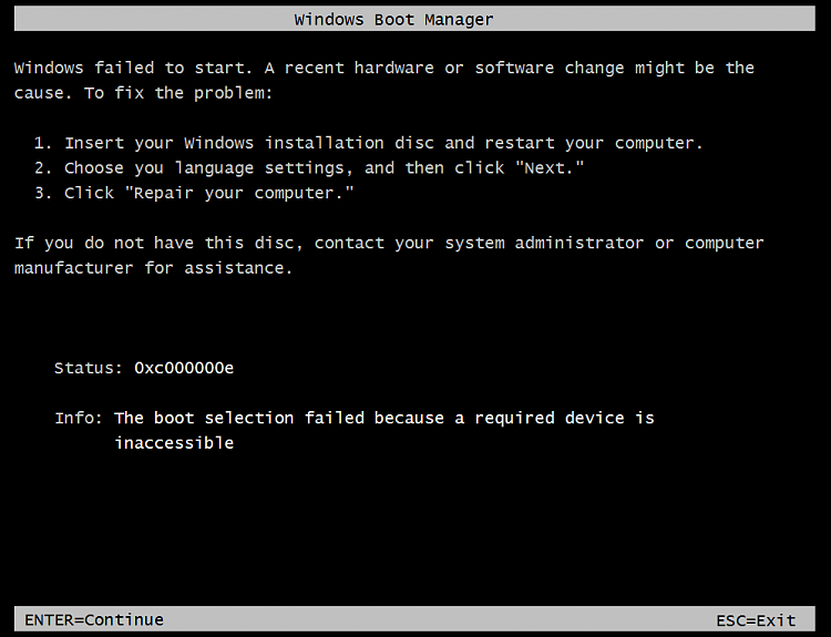

    Thank you very much for the instructions. I am still getting an error OxcOOOOOOe
    The installation was in full then on reboot that is where I got this message and that the installation was rolled back and my current version was back.
    I dont have any of the disks on the win7 enterprise that is why Im trying to install win7 home instead so I will have the disks.
    I am trying to use a new volume I named E: I formatted it before install and all went well up to the reboot as Id stated.
    Attached Thumbnails Attached Thumbnails Failed install windows7 home to windows7 enterprise-boot_error_status_0xc000000e.png
  4.    #4
    You'll need to boot the installer and if you continue getting the error showing it's instead trying to boot the hard drive, replace the installer with the one provided - using the tool provided to burn to DVD or flash stick.

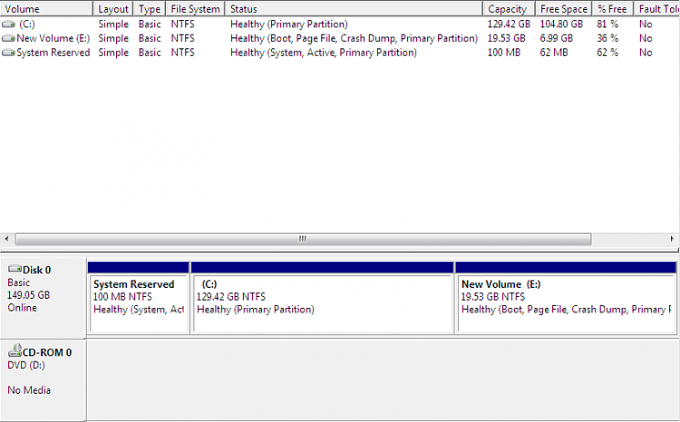

    After you've moved everything off Enterprise post back a screenshot of Disk Management - Post a Screen Capture Image and we will give you the steps to remove Enterprise which probably still has the System boot files for both OS's, to Recover Space Used by an Older OS .

    Ive cleaned up enterprise and Im now on win7 home. This is the screenshot.
    E: is the win7 home
    C: is win7 enterprise
    Attached Thumbnails Attached Thumbnails Failed install windows7 home to windows7 enterprise-screenshot_1.png
  10.    #10
    Because you ran the installer from OS instead of correctly booting it The new OS will not boot as C. I would do it over and this time follow Reinstall tutorial below.
    If you have everything off the old OS then delete all partitions during install.
