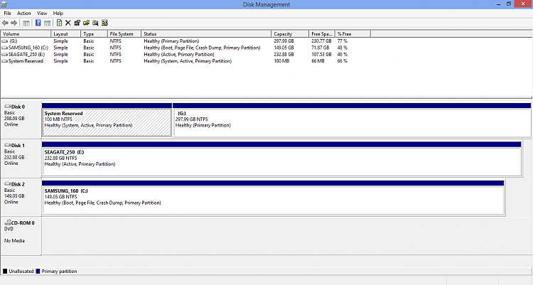

I think you've already answered the question successfully, but here is the DiskMan shot you requested for confirmation.
Disk 0 is my Win7 drive.
Disk 2 is my Win8 drive (currently running).

Both OS's are being booted by System Reserved, as signified by it holding the System flag. If 8 was booting itself it would show a System flag since you are booted into it now - which we know by the Boot flag and the title border.
To leave the Windows 7 System Reserved partition on another hard drive booting Windows 8 is not optimal.
I would install EasyBCD to Windows 8 to move Bootmgr - Move to C:\ with EasyBCD - Windows 7 Forums, reboot to confirm Windows 8 drive is now System flagged, unplug the other hard drives to verify bootability.
If EasyBCD doesn't work then Mark C Partition Active, unplug all other drives to run Run Windows 8 Automatic Repair .
I see Mahmoud who wrote EasyBCD is here now so maybe we can get him to comment!
