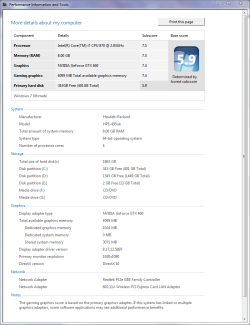

I have a six-month-old HP desktop computer that from day one has been plagued with varying boot times.
Today was the final straw when I booted up after an overnight shut down and sat through an eight-minute wait as the computer sat at the Windows Starting screen before completing the boot sequence.​
I have also been having problems with using Sleep. The computer wakes from sleep with no problem, but if I then shut down and restart, it hangs at the blue boot option screen for two or three minutes.​
I get the same symptoms whether I use HP's pre-installed operating system or my own operating system after a clean install.​
I have checked that the memory is seated correctly, made sure there's no dust in the case and that there is nothing overheating.​
My drivers are all up-to-date and I've checked that it's not any of my peripherals causing the system to hang for this length of time.​
HP support has been pathetic so I'm not all that keen on sending my box in for repair.....so if anyone has any ideas I'd be eternally grateful.​
