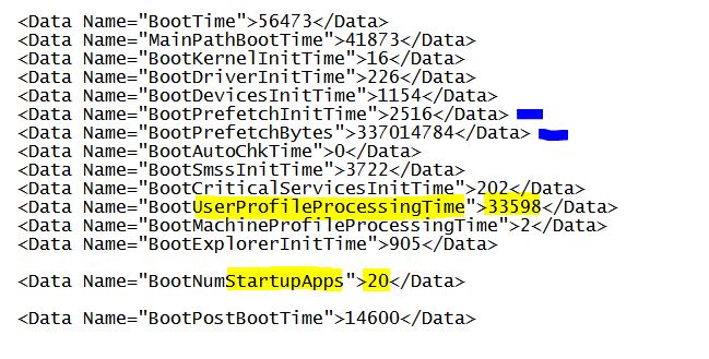

Open Event Viewer. (Click Start, type Event, select Event Viewer under Programs)
In the left pane, expand Applications and Services Logs > Microsoft > Windows then navigate down and expand Diagnostics-Performance. Click on Operational.
In the center pane, click on the first Event ID 100 line. Below that list click on Details Tab, then make sure the Friendly Orb is on.
In the right pane, click on Copy then select Copy Details as Text.
Paste the the text into a new reply here and post.
Sample Boot Event:

Your boot startup programs (20) and user profile customizations are consuming the most time. Trim those back and boot time will decrease. That's well over 35 seconds worth.
