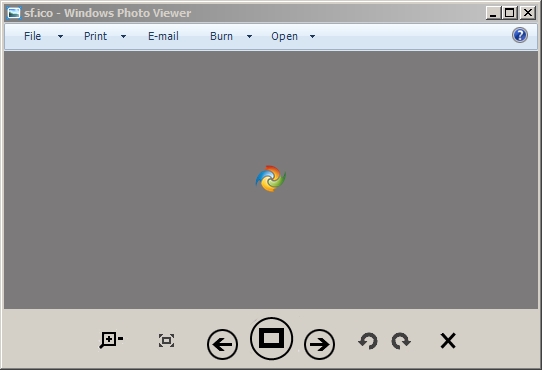

Take photoviewer.dll as an example. SFC will want to replace it as it doesn't match the original file. I've modified it to get a metro style photo viewer in Windows 7.
How restore system files when System File Checker won't work-windows-photo-viewer.jpg
So what I'm saying is don't just assume that SFC detecting problems actually means that anyting needs fixing. Check first before repairing!
