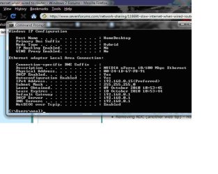

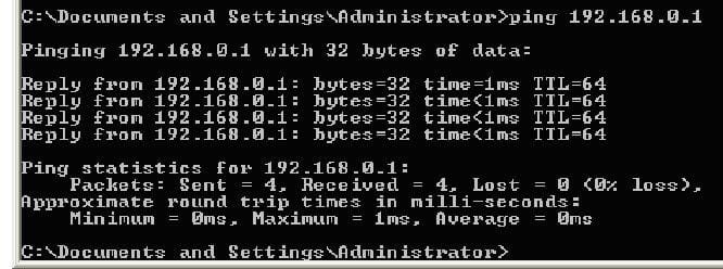

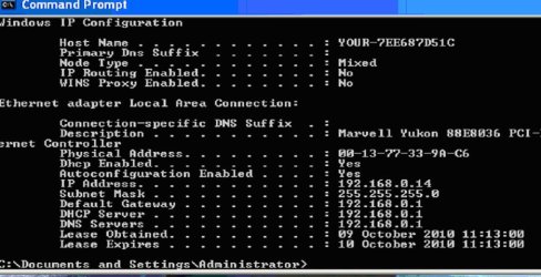

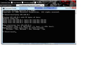

The cable is Cat 5e and is about 10 metres long. I attach four screenshots - the ipconfig/all and the ping result for the desktop (the computer running windows7). I also did the same thing for the laptop by unplugging the cable from the desktop and then plugging it into the laptop just in case this would be of any assistance.
Thanks
