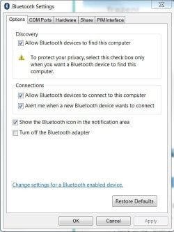

Can you see the bluetooth icon in the notification area? Click on it, then click on "Open Settings". This is what it looks on my computer.
Too many to describe...
yes ther is a bluettoth icon in taskbar...n my 'bluetooth settings'is just the same as urs....and yes it starts wen computer starts.....bt i dnt get the option of send or recieve file.....

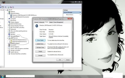

In device Manager, do you see Bluetooth? Mine shows like this.
When I double click on the Dell card, this is what I get.
Can you post a snip of what bluetooth card you see in the device manager?
ok...here's the snap.....n i those two devices drivers dnt get installed...

The peripheral devices are not core to the functioning of bluetooth, you should still be able to send and receive files.
