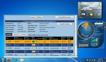

before we go any further, i just had a question about the channels for my wifi connection, if the channels weren't clear, then wudn't the rest of the laptops on my network also be experiencing the same problem? i used xirrus and i'm running on channel 1, and there is 1 other network that is using channel 1 but the signal for that is really weak, here's an image of what i'm talking about

Not always, it depends on many factors. I can't see the weak signal channel 1 in your screen shot but it may be worth trying a different channel that isn't on the list of used channels. It certainly won't hurt anything to try a different channel.

Looking at your Xirrus info the default gateway is probably 192.168.1.1, while your in there it would be best to set the router to use WPA2 and AES encryption.

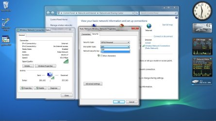

I knew you could figure that out once you got into the routers settings. I was about to post a screen shot from my router if you were having any problems.
The only changes you should need to make to the wireless manager on the other machines is to change the security to WPA2 because it looked like you were using just WPA before. The picture below shows you where.
Of course now you need to wait and see if the connection drops out again. If it's a weak signal that will cause problems with dropped connections also.
