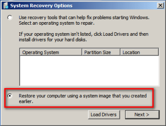

Also using Windows 7 built-in tools, it couldn't be simpler. Whenever I need to restore an image, I just boot with Windows 7 DVD, choose Repair your computer, and then choose an image I've stored on external drive.
