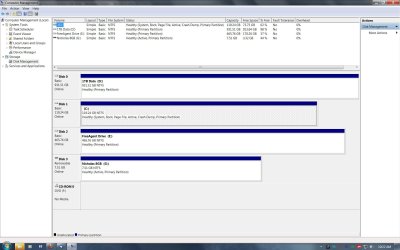

Please post back a screenshot of your full Disk Management drive map and listings, with all drives plugged including the external and any flash drives you regularly use.
The best method to avoid these problems when you have separate HD's is to unplug the old OS HD during install to the new SSD. Then after install plug back in the other HD, boot preferred OS HD by setting first to boot in BIOS Boot Order, boot the other using one-time BIOS Boot Menu. This keeps the HD's independent to come and go as you please.
We sort these issues here all the time but need to see Disk Mgmt screenshot to see for sure.
Is this the info you need?

There is some very useful information and an outline of marking a HDD/partition inactive at Option Two #2 along with other pertinent info in this tutorial at the link below.

Use Diskpart to mark G Inactive following these steps from elevated Command Prompt: http://www.sevenforums.com/tutorials/71432-partition-mark-active.html
Then move C to DISK0 position by swapping cables with D, changing BIOS Boot Order so C is set to boot first after DVD drive.
With these changes everythign is configured correctly. If problems persist I would update the BIOS if needed; if not, reset the CMOS: Clear CMOS - 3 Ways to Clear the CMOS - Reset BIOS
