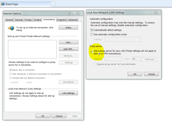

Ensure that your IE browser has not been hijacked here. The check box should be UNchecked.
Also, open a cmd box. Type IPCONFIG /FLUSHDNS and press enter.

I tried that a little bit ago at my house but it had no effect. plus that wouldnt matter if i tried connecting from different locations right??

that box is unchecked and i also tried the ipconfig /flushdns command and still have the same result
