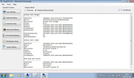

Hi! I've used method 2 and can choose between XP and 7, but there is still one problem well described here by p314: strange crash when dual booting Windows 7 and Xp - The NeoSmart Forums
Making it short: "When I start I get the option to boot XP or Windows 7, if i load XP and then restart and load 7, it switches off while loading 7 and restarts. If I select 7 again it offers to Start Windows normally or go into safe mode etc. If I select Start Windows normally it will work this time. Then if i go back to XP i get the same problem, restarts first and then will start under start windows normally."

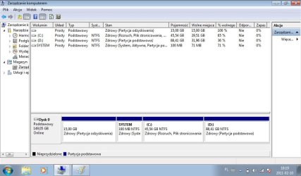

7 is on C: and XP is installed on D:. This is how it looks from 7:
The solution might be very simple, but I couldn't find it. How to solve it?

You cut off the Disk Management drive map and listings sizes, so we can't see the most important information.
Please post the maximized Disk Mgmt full drive map with full listings. Click and drag the Volumin and Akcje borders to left and right to make more room for listings.
Please tell us what is on each partition.

Sorry for those pictures, they were no help.
Partitions:
System (Primary,Healthy,Active)
C: (Boot,Healthy,PageFile,CrashDump,Primary) - Windows 7
D: (Primary,Healthy) - Windows XP
15 GB - Recovery, Healthy

First try installing EasyBCD 2.0 to Win7, delete XP OS on Edit OS tab. Restart to check behavior.
On restart to Win7, in EasyBCD add XP on Add OS tab, accept boot files if offered, it will autocomplete, Save, Restart.
This should refresh the Dual Boot so that hopefully it works correctly.
If not you can run a Repair install of Win7 which should completely reconfigure the Dual Boot with XP: http://www.sevenforums.com/tutorials/3413-repair-install.html?ltr=R
If the same problem reoccurs then you likely have boot sector corruption, overcome by wiping the HD before reinstalling both OS's.
But first make sure you have the latest BIOS update and if so reset the CMOS: http://pcsupport.about.com/od/fixtheproblem/tp/clearcmos.htm
I've just tried to refresh the Dual Boot as Gregrocker said, but there is no change. Complete restore using Samsung Recovery Solution and Recover partition (I don't have Windows 7 DVD) didn't help too. Seems that only formatting and installing everything anew could help. Thanks for your pieces of advice Gregrocker and Theog.
