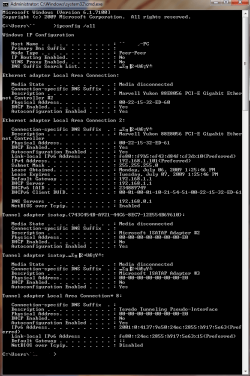

Type cmd in start menu search box, hit enter. Then in the black box, type ipconfig /all, hit enter. Please post a screenshot of this and we will probably be able to help you then if you still need.

Thanks for the suggestions, but I'm afraid none of them worked. I uploaded the ipconfig screen though. Hope that helps.

Strange, looks as tho its using 1.1 as IPv4 dns and .0.1 for IPv6 dns, and this would be a forseeable problem.
did you manually type anything in for IPv6?

Nope. IPv6 settings are all automatically obtained.

make sure you have the dns servers in IPv4 as 192.168.1.1 - not 0.1
