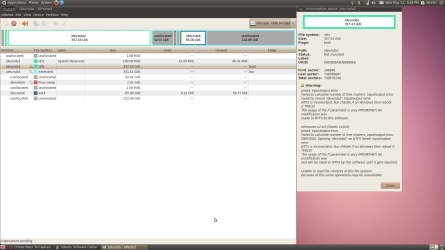

as you can see my hdd is a mess :P
sda1 is the windows system recovery (i think)
sda2 is my windows installation. here it's defined as NTSF but in DISKPART it's shown as RAW... hopefully this means my data is still recoverable (because I failed physics 2 and really don't want to rewrite those labs next year :P)
sda3 is where my SUSE install is located... as you can see it's pretty messy lol. I'm going to uninstall my openSUSE OS so if the fix is made easier by getting rid of the partition it's not a problem.
thanks a lot for your help
