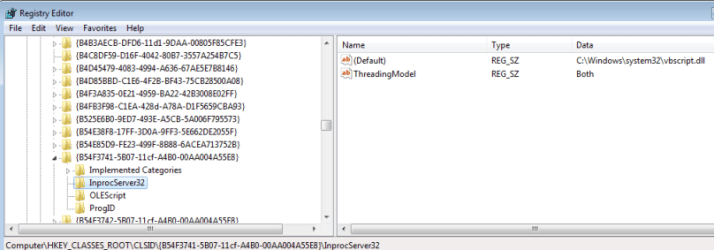

Nope. InprocServer32 is a key, not a string.
Check this reg file and screenshot in attachment
Replaced InprocServer32 to 'key'.
The key in my registry is exactly like your screenshot, however mine is without the other key 'ThreadingModel'.

The key Threadin Model is found after adding the Reg File..
Thanks.
You are welcome. You probably need to add ThreadingModel just in case.
