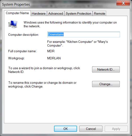

(1) You need all computers on the network to be in the same "workgroup". Start -> right-click on Network, to see your current "network view" within your workgroup:
You need each computer on the network to have its own unique "machine/computer name" on the network. If they are not unique, change them. Same with the workgroup name: if they are not the same, change them on each computer so that the workgroup for all of them IS the same. Push the CHANGE button and enter the values as appropriate:
Start -> right-click on Computer, select Properties, and then show the portion dealing with computer name and workgroup name:
Click on the "Change settings" link on the right, to get the System Properties window where you can then make your changes.

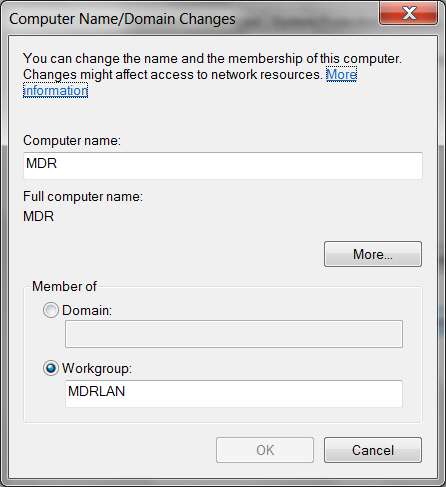

Push the "change"button, to change this information. You will then get the Computer name/domain and workgroup name changes screen:

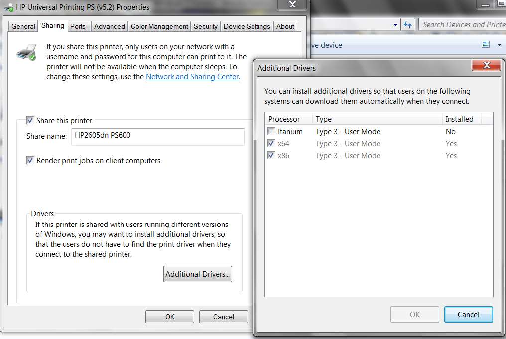

Each USB-connected printer must have "share this printer" specified in its own local setup for that printer. Start -> devices and printers, select your USB-connected printer on the machine to which it is locally connected, right-click and select Printer properties and then the Sharing tab:

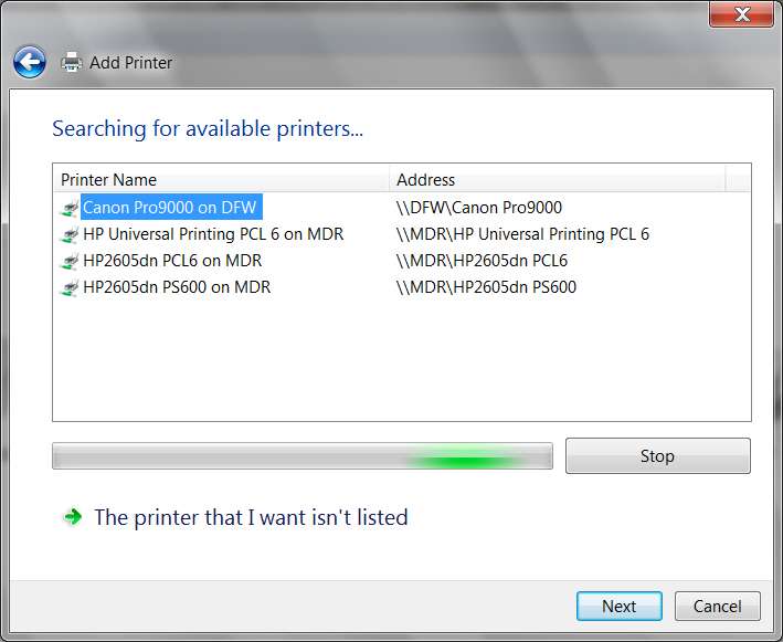

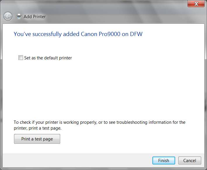

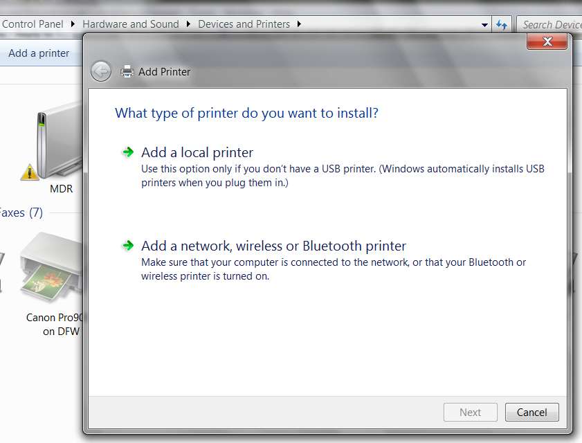

Each client computer on the network needs to go through the "ADD PRINTER" dialog, and then follow the "network, Bluetooth, or wireless" printer wizard. You will be able to "see" all "shared" printers on the other host computers on the network, and you simply need to select the printer you want to "add" and push the NEXT button in Win7 to complete the process. With WinXP once you select the desired "shared" printer to add, you right-click and select "Connect...". Same result.
Back at the host machine with the USB-connected printer, if it is a 64-bit Win7 system then 64-bit printer drivers got installed. If there are only 64-bit client machines on the network that want to make use of that "shared" printer, there's no problem. But if there are 32-bit (e.g. WinXP) client machines that want to print on this USB-connected printer hosted by a 64-bit Win7 system, you need to "ADD ADDITIONAL DRIVER" to that 64-bt printer definition, adding a second 32-bit version in addition to the already installed 64-bit version. Now the host system can "ship" the proper printer driver to the client computer at "connect time", providing support for both 32-bit and 64-bit clients.

dsperber- thanks for the great info...however do you have any advice on adding additonial drivers on the host computer when the only place you can get the printer driver is Windows Update? I tried adding the driver for 32 bit systems to by 64 bit system host but it prompts me for a driver location :(
You have to have the 32-bit driver downloaded (or otherwise available) at that point in the dialog.
If you download a 32-bit installer file from manufacturer or Microsoft Update Catalog (which you MUST access using Internet Explorer, not Firefox), you then use WINRAR or similar to expand it (not run it, just expand it so that you can then point to it). Then, in one of the expanded sub-folders, the INF file for the 32-bit environment will be found. That's where you want to navigate to when the "secondary driver" install wizard dialog asks you for it.
Alternatively, if you have the printer installed on a 32-bit Windows sytem, you can point to the Driver Repository on that system (assuming you have network access to it) when the install wizard asks you for it.
Or, if you have a 32-bit Win7 installation DVD and the printer is supported by Windows, you can MOUNT the WINDOWS.WIM file on that DVD and point to the Driver Repository.
Etc., etc.
One way or another it's up to you to make that 32-bit INF file accessible and then navigate to it when the wizard asks you for it. It is YOU that needs to make it available when it's this secondary driver installation process to support x86 clients from a x64 host.

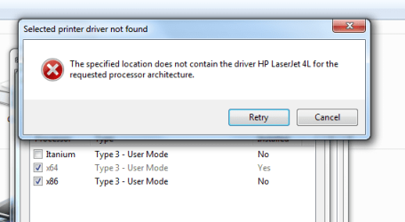

ok so
when I get to the driver location question i've tried browsing over the network to the Win 7 32 bit machine and I select the correct printer driver .inf file through the Driver Repository on the 32 bit laptop however it still doesn't like it and gives me the attached error. From what I found on line I think it may have something to do with the driver names not matching or etc.
Please anymore advice would be great!

Well, I would have thought it would work exactly as you've done.
Here's what I would think should be an absolutely reliable method (as I've described earlier).

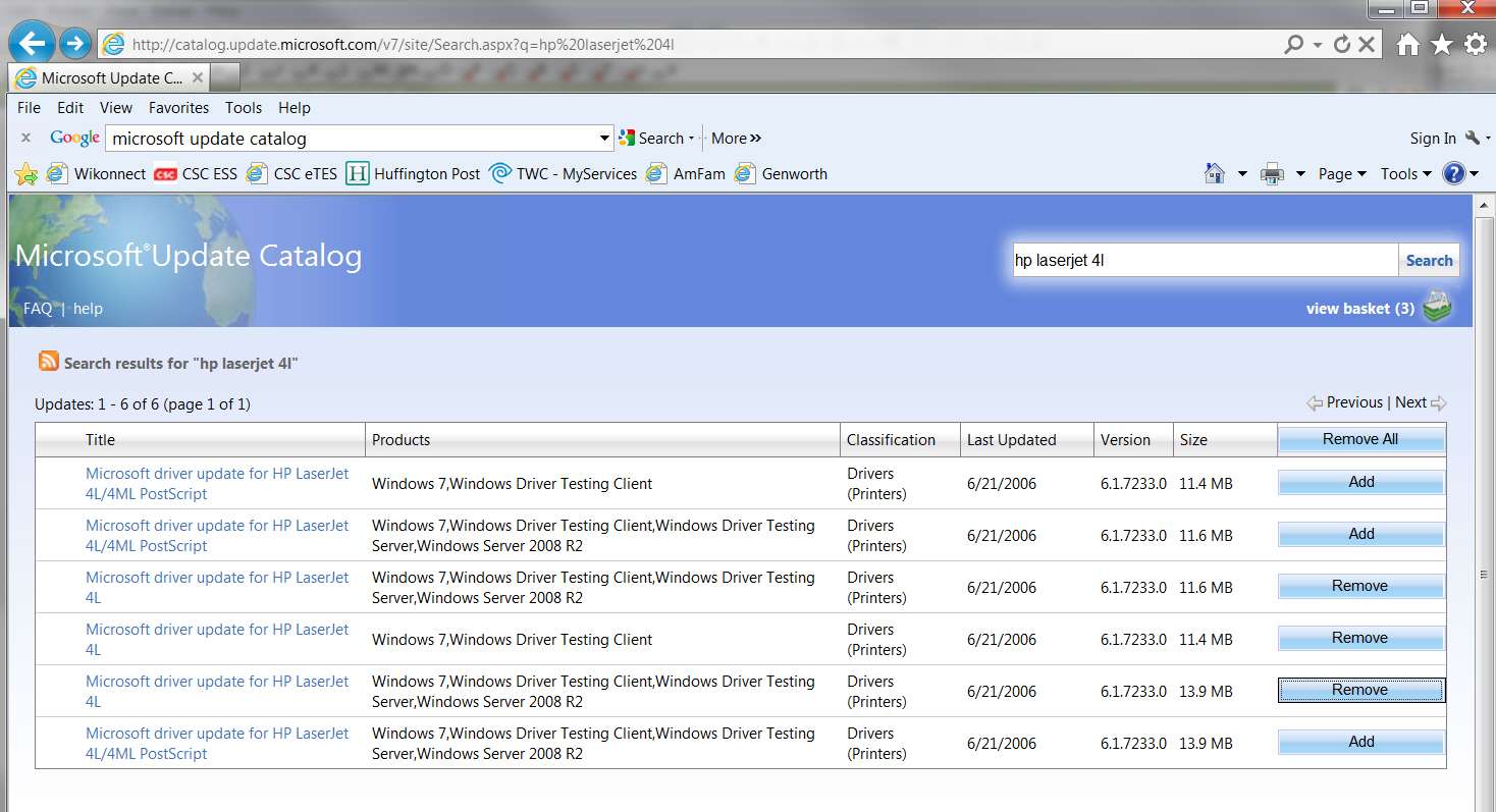

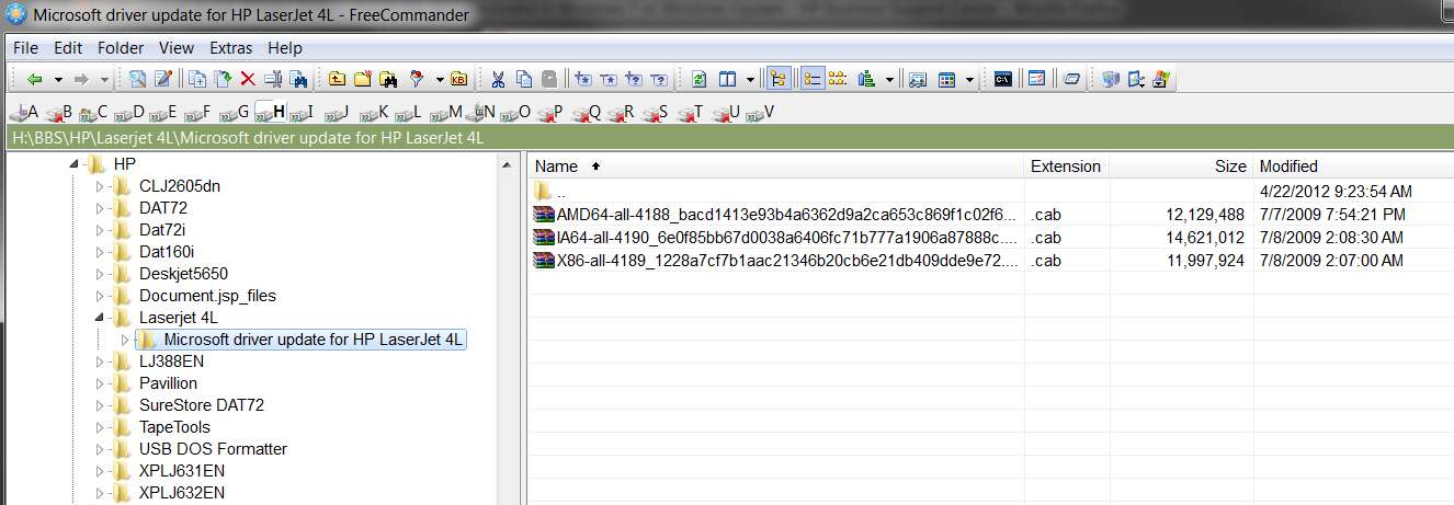

(1) Go to the Microsoft Update Catalog site and search for HP Laserjet 4L. You will get six "hits", three for Postscript drivers and three for PCL drivers. The three driver versions are x86, x64, and Xeon.
MS's descriptions don't indicate which is which, so just push the "add" button for the three PCL drivers and download them all. You can then see which is which and can expand the x86 version for your needs.

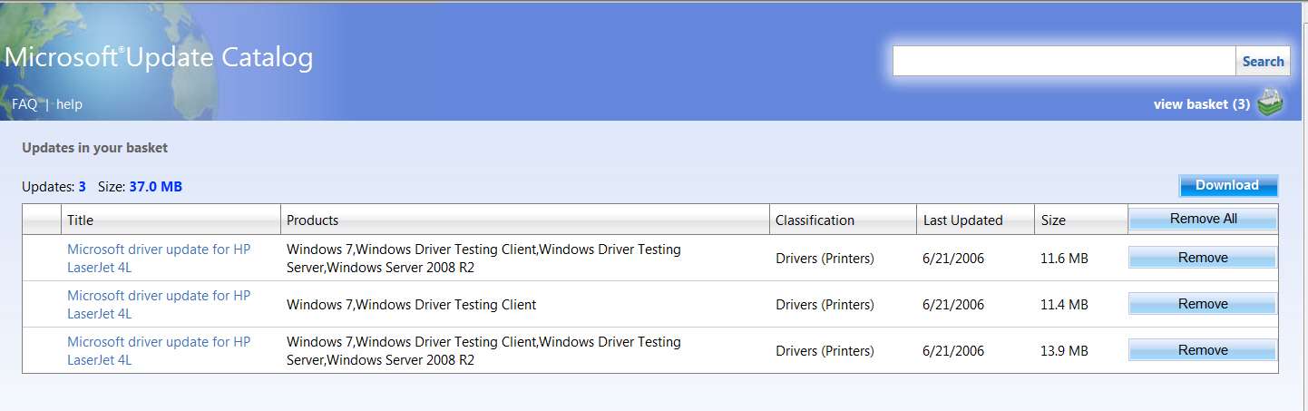

(2) Then push the "view basket" link to go to the next page, which shows the contents of your download group, which will show the three driver files you've "added".
(3) Push the "download" button to get all three files downloaded to your target folder to hold these three zip files.
When the download if finished, you'll have one folder (named "driver folder for HP Laserjet 4L") containing the three driver zip files inside that folder.

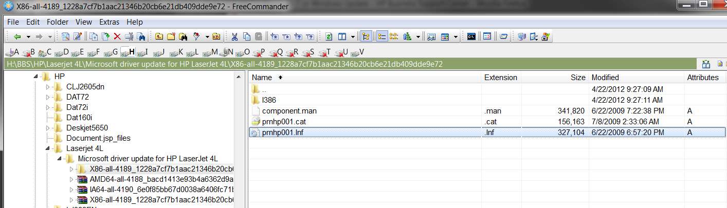

(4) Right-click on the x86 driver zip file and invoke WINRAR or whatever you use, to expand that driver zip file into its own folder. When you then look inside that folder you will see the file PRNHP001.INF for 32-bit, along with the i386 folder containing the actual 32-bit driver DLL files, PPD files, etc.
This is the INF file you should point to in that "add secondary driver" dialog when you get to that point.
I would think this HAS to work for you.
NOTE: actually, the downloaded files are .CAB and not .ZIP. But you can still use WINRAR to expand them.
