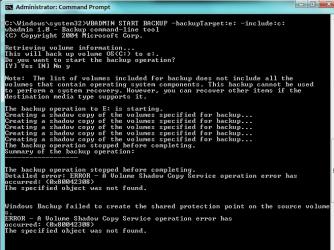

Sure they will work. They do not rely on the Windows imaging.
One other thing you could try:
Open an elevated commend prompt and run this command
WBADMIN START BACKUP -backupTarget:f: -include:e:
where 'f ' is the disk to which you want to image and 'e' is the partition you image. This command uses some of the same routines as the restore points. Have a look whether that works.

Here's what i got:
(I'll try the 3rd party imaging suggestions you made) -- thanks for your help
Windows 7 Home Premium
But this is interesting anyhow. It shows that your shadow copy service is corrupted - finding that out was the purpose of the exercise. I think you can repair that only with a startup/repair.
