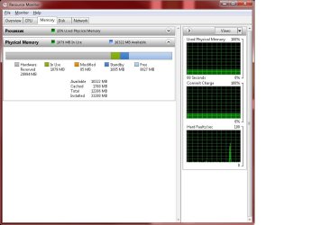

I grabbed another HDD, a 74GB WD Raptor I happen to have handy & installed 7 on it w/all the same programs and settings as the dual-boot HDD. It reported dual, dual core CPU's and reported 12GB RAM installed & usable (however its giving me a BSOD error of X0124 which I will research independantly from this thread).
Would running Win Repair resolve the CPU/RAM issue?
I was incorrect on the RAM. I have both Micron & Corsair installed. Just loaded the box up for testing purposes. I will be ordering new RAM once I have all the issues/bugs sorted out.
All requested SS's are included. Thanks for taking a look.

Bizarrely, it shows:
hardware reserved - 20994MB
available - 10322MB
cached - 1780MB
total - 12286MB
installed - 33280MB
Something's clearly wrong, and it's obviously at the BIOS/hardware level. Obviously, the motherboard manual should be referenced for memory usage information.
I think it is tied to the mismatch in slots #7 and #8 for those two 1GB Corsair cards which are actually different part numbers, and have different sets of JDEC timing numbers.
The pairs of memory cards in #1/#2 seem matched, #3/#4 seem matched, and #5/#6 seem matched.
But #7/#8 seem to be incompatible. Can't help but believe this is directly a factor. These only add up to 2GB anyway, so losing them wouldn't be a major issue in the short term.
It would be worth an experiment to remove the two cards in slots #7 and #8, just to see if things clean themselves up.
Also, the 20994MB "hardware reserved" item in Resource Monitor is obviously bogus. But it would be interesting to see where this memory is theoretically reserved.
Start -> Run -> DEVMGMT.MSC, to get Device Manager. Then View -> Resources by type, and close up any expanded categories except for Memory which should be expanded. The information shown is by hardware device, showing a low-high 64-bit hex address range.
Unfortunately, the subtraction is not shown in a separate column or item which would be very helpful and user-friendly. But it's not. So it's not obvious without using Calculator to do the required hex arithmetic (unless you're familiar with hex in your normal life) and can spot the "culprit" somehow primarily responsible for 20GB "hardware reserved" which should really stand out I would imagine... since only 12GB is actually installed.
Anyway, looking at this memory assignment should be very interesting.
But first, I'd pull the two mismatched 1GB Corsair memory cards in slots #7 and #8 and see what happens.

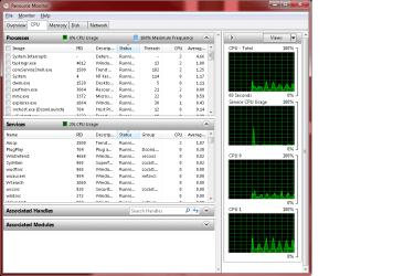

RAM is not the reason for the dropped CPU
I appreciate the help with this but I'm not a newbie. Prior to posting I did begin troubleshooting this. The RAM isn't the issue. I've already pulled all RAM from the MoBo and booted to XP & 7, 1 stick at a time. All work just fine. When I take out the Corsair RAM, 7 reports 8GB installed & usable. The RAM is not the issue as to why suddenly 7 is not reporting/"seeing" both CPU's. Keep in mind until just a day or two ago 7 in the current config was reporting both CPU’s & all 4 cores.
And yes all RAM is DDR. This is an older MoBo by Tyan and older Opteron CPU's.
I guess I worded the RAM part incorrectly in my initial post. For that part I just wanted to know why 7 is reporting 32GB installed but only 12GB usable. Why wouldn’t' it just error out or not even been reported by 7? I know all about miss-matched RAM, MoBo settings, etc. I loaded all compatible (with MoBo) RAM just until I'm done testing.
This is really getting some distance from the really critical issue of my initial post. Hopefully to direct this the right way; I need some help or direction as to what the next step should be to get both CPU's recognized & usable by 7. I did run the win repair earlier today and it didn't find anything to fix.
As already stated, if I boot to XP, both CPU's & all 4 cores are reported. If I boot to 7 on the other HDD I installed it on today, both CPU's & all 4 cores are reported. It doesn't matter if I have only the Micron or the Corsair or mixed sticks of RAM on the board. It still boots up just fine and reports both CPU's are there and usable.
And just in case I've included an SS of the CPU tab in RM.

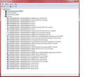

It's not BIOS/Hardware level
I'm not seeing how it's "obviously" BIOS/HW level. The only change that I've deviated from in the default BIOS config/settings has been changing the setting for O/S type from x86 to x64. This was done per the manual so "obviously" the manual has been referenced along with Tyan's website.
Additionally I've attached SS of DM, By Type, Memory.
Sounds like the initial Win 7 install is corrupted in some way.

At any rate this is resolved. How you might ask. I have no bloody idea! I have been trying just about anything I can think of or run across researching this (which is next to nil....actually nil).
Just as a shot in the dark I booted into safe mode (again) and poked around. As usual I didn't find anything new or unusual so I re-started.
I booted to 7 and once the O/S came up I checked taskmgr>performance (tab) as has become habit after every re-start or cold boot. Low & behold it was reporting 4 cores in CPU usage history. I checked the System panel and it's reporting Dual Core AMD Opteron Processor 280 2.41 GHz (2 processors).
Unfortunately I have no idea why. I've been in and out of Safe Mode several times a day since this started occurring. This last time I didn't alter any settings or configs.
The computer has been up & running stable for just over 48 hrs as well. I'll report back if anything should change.
Oh regarding the RAM issue. It's the one stick of the Corsair XMS RAM that is throwing the count off & causing 7 to report 32.0 GB installed **GB usable. I've removed it a couple of times and every time I do 7 reports 11GB installed & usable. When I re-install it 7 reports 32GB installed 12GB usable.
