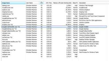

While at idle, task manager uses the most CPU (40-65%) out of 2.0 Ghz (x 2 cores). As for dust, the inside is spotless. I havent a clue about temperature, but it is hot enough to be a cause of concern. It is about the same temp at idle and at load, and it is most commonly used on a desk away from obstructing clutter.
Can you open Task Manager go to Processes tab then open the window to Max size and post a screenshot using "Snipping Tool" so we can see what else is taxing the cpu? As for temps you could install and run "CoreTemp" to check what your running at. Is your cpu fan running hard at all times? You could be running hot because of your cpu running 50%+ all the time. I have read a few reviews about your model of laptop and all said it ran on the hot side, so you also might want to check out a cooling pad for it.

Surprisingly, after running Task Manager for about 10 minutes, CPU usage by its process decreases dramatically. The fan does run full out all the time. Attached is a snip of processes at idle, process while running applications that I would have running most of the time, and Core Temp. Hope it works for you.:p

I dont really see any weird things going on in your pics of task manager, Resource Monitor might give a little more detail ... Start orb>searchbox>resmon.exe
High cpu usage without user initiated processes would mean you've likely got a ton of startup items. Click on the Start orb, type msconfig, hit Enter. In the msconfig window, click on startup tab and uncheck anything you dont need to start automatically. E.g. on my computers, only the AV, touchpad driver and password manager are checked.
You also might want to check out why there are so many "Google Chrome.exe" running at once. In your "at load" pic were you running Java? If not check that out.
It doesn't seem to tell much more, other than how many threads I have.
This will probably help the most. I went from 16 to 5 startup processes.
Most likely, this has to do with the fact that Google Chrome sandboxes different parts of the browser, thus reducing crashes.
Yes, I was running a java-based piece of software. West Point Bridge Designer to be specific.
