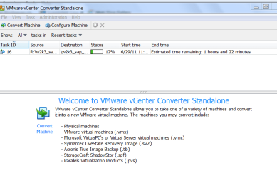

Does this mean that if I install Win7 on an XP machine so that it will dual boot into either Seven or XP, that I can then install VWWare and convert the XP Os into a VM and then delete or discontinue the dual boot?
I am on the verge of upgrading to Windows 7 on my old workhorse and I really would like to avoid having to reinstall and reconfigure everything
Windows 7 Ultimate x64Intel Core i5 320ghz4gbDDR2 800mhzNvidia Gforce 9800
custom
4gbDDR2 800mhz
Nvidia Gforce 9800
Creative Audigy 2 ZS
NEC
1280x1024
500gb ATA
320gb ATA
Hi there
You can CLONE an entire PHYSICAL OS (process is known as P2V Physical to Virtual).
Note however that some programs that make direct calls to the real hardware won't run on the VM -- these are usually modern games and DVD playing.
Video via the Internet is perfectly ok on a VM now as is some limited 3-D support.
The main use is that if you have a load of apps like say Office on an XP machine you don't have to go to all the hassle of re-installing on the VM.
Also note you *May* have to re-activate -- although if you target the vm conversion on the SAME PHYSICAL machine generally no re-activation is required.
In VMWARE workstation you can then clone this vm again (V2V == Virtual to Virtual) which will probably run on a totally different machine without requesting activation either -- since the Virtual Hardware should be identical the activation process shouldn't come into play.
I've done zillions of these and only very rarely have I been asked to re-activate and it's been 100% successful.
Note when using vmware converter run in ADMINISTRATOR MODE when doing a P2V conversion or it will fail right at the END of the process !!!!.
BTW an EASIER way is to backup your XP system via acronis to a *.tib file, load up your W7 OS and then convert the *.tib acronis backup to a VM using the vmware converter.

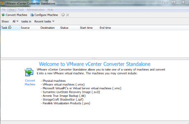

screen shot shows the types of files that can be converted to a VM.
