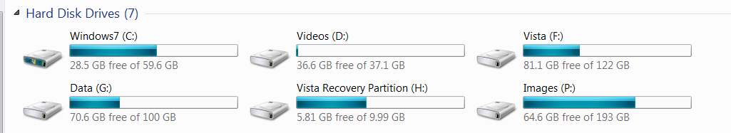

This is the second best choice. As BFK says, seperating the installation and switching via the BIOS is a much better deal.
As to the allocation of drive letters. There is nothing to worry about it. I still have Vista and it's recovery partition on this system. Below is a picture to show you how it may possibly look like. Note: I have one SSD and two HDDs on this system and there are some more partitions that do not show in the picture.
