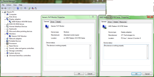

Here's a picture of my Device manager for Display and my monitor.
Edit: "Solution": When I enabled Onboard card in BIOS, I went to device manager and uninstalled it myself and reinstalled the Radeon graphic card. And it works fine now. Thank you for the help!
Hp users, if you have the same problem as mine, use this!
