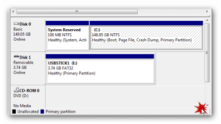

D: is my dvd disk. No cd or dvd in it. There is a hidden partician for Mbr and whatever for the install. Here is a picture.Disk partician.png
I also just recently erased an A: partician that I had made for data.

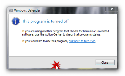

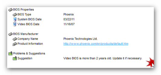

1. I already have MSE installed. It has been having side by side errors #72. I looked it up. Many others also have the same errors, yet no solutions yet. Defender was auto shut off by MSE when I installed. I checked.
