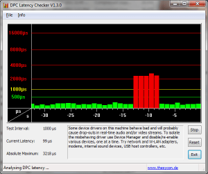

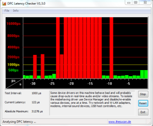

i downloaded DPC latency and was able to isolate the problem to the ATHEROS AR5B97.

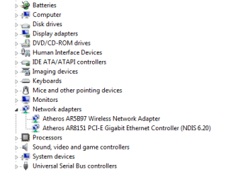

I have two atheros devices on my computer (see screenshot)
i frist tried disabling the second one (Atheros AR8151 PCI-E Gigabit ethernet controller NDIs 6.20), no change.
I disabled the first one (Atheros AR5B97 Wireless Network Adapter) and i got no red lines on DPC latency!

I installed only the WLAN Atheros 9.0.0.202 W7x64 drivers. Latency still occurs but much much less than before. These are the best drivers for the W-LAN card so far.
DPC Latency still has spikes, but not enough to cause repeated stuttering or popping in the audio or video. The sound glitch will only occur if DPC latency spikes to or above 16000us. I have been testing the laptop extensively and it has been running beautifully. :D

So I had almost red DPC while Skype and other Internet activity and it made it hard to talk and listen to music on modern Core i5 with SDD laptop! With the help of DPC Latency checker (btw it worth checking LatencyMon to get additional details) I found that it was WiFi adapter - Atheros AR9002WB-1NG and Ethernet adapter - Atheros AR8151 PCI-E.
