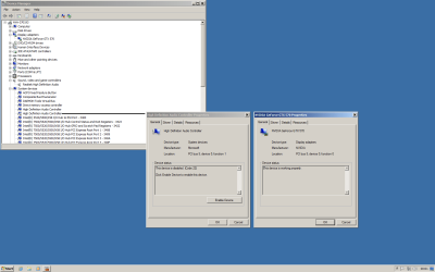

Update:
A person on the above forum listed the following possible options:
1. Get a dedicated soundcard to override the video card driver - impossible to me as I have a small box (Shuttle)
2. (see picture) Disable the audio channel with the same bus as the video card, in effect disabling the overriding effect of the video card. Tried that, no fix.

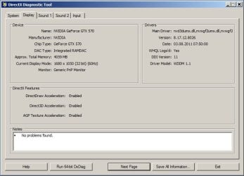

My friend, you forget Im European!
NVIDIA drivers are from 3rd of august and the Sound drivers I could see are from 30th august 2011. Il copy the DxDiag as a text file here:
Sound Devices
Description: Realtek Digital Output (Realtek High Definition Audio)
Default Sound Playback: Yes
Default Voice Playback: Yes
Hardware ID: HDAUDIO\FUNC_01&VEN_10EC&DEV_0888&SUBSYS_10EC0888&REV_1003
Manufacturer ID: 1
Product ID: 100
Type: WDM
Driver Name: RTKVHD64.sys
Driver Version: 6.00.0001.6449 (English)
Driver Attributes: Final Retail
WHQL Logo'd: Yes
Date and Size: 8/30/2011 17:28:46, 3069032 bytes
Other Files:
Driver Provider: Realtek Semiconductor Corp.
HW Accel Level: Basic
Cap Flags: 0xF1F
Min/Max Sample Rate: 100, 200000
Static/Strm HW Mix Bufs: 1, 0
Static/Strm HW 3D Bufs: 0, 0
HW Memory: 0
Voice Management: No
EAX(tm) 2.0 Listen/Src: No, No
I3DL2(tm) Listen/Src: No, No
Sensaura(tm) ZoomFX(tm): No
Display Devices
Card name: NVIDIA GeForce GTX 570
Manufacturer: NVIDIA
Chip type: GeForce GTX 570
DAC type: Integrated RAMDAC
Device Key: Enum\PCI\VEN_10DE&DEV_1086&SUBSYS_15713842&REV_A1
Display Memory: 4059 MB
Dedicated Memory: 1248 MB
Shared Memory: 2811 MB
Current Mode: 1680 x 1050 (32 bit) (60Hz)
Monitor Name: Generic PnP Monitor
Monitor Model: DELL 2007WFP
Monitor Id: DELA019
Native Mode: 1680 x 1050(p) (59.883Hz)
Output Type: DVI
Driver Name: nvd3dumx.dll,nvwgf2umx.dll,nvwgf2umx.dll,nvd3dum,nvwgf2um,nvwgf2um
Driver File Version: 8.17.0012.8026 (English)
Driver Version: 8.17.12.8026
DDI Version: 11
Driver Model: WDDM 1.1
Driver Date/Size: 8/3/2011 07:50:00, 15064168 bytes
As you can see they are both from august this year ;)

Believe it or not, I have suddenly the same problem after my power supply had to be replaced. And I also have a Shuttle with a graphic card.
If by any chance you come across this thread (long time passed since you posted yours) -please let me know if the issue was fixed.
