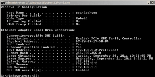

I have a Motorola SB5100 modem connected to a Netgear WGR614 v7 router. I then have my Xbox 360 and Desktop connected to the router. With this setup, there will be periods of time in which my internet will disconnect, but all the lights on both devices will stay lit. When I disconnect my Desktop from my router and plug it directly into my modem, and this issue appears, when I run the Network Troubleshooting on Windows 7 it tells me "The default gateway is not available."
This issue has been driving me crazy for the past few weeks now. I've placed multiple calls to my ISP and had several tech visits, all to no avail. I've also tried searching the internet for fixes, of which none worked. I have tried:

If anyone has had this similar problem and has advice/a fix, I'm open to suggestions. Attached is IPCONFIG and a HijackThis log.
Is this an ISP provided router, or your own??? If it is your router, try updating the firmware first... I didnt see that in the list of what you tried. If it is an ISP provided router... DEMAND A NEW ONE!
Did you reboot PC or release/renew IP after trying this switch? It sounds like maybe you didnt and the PC was looking for the router at the Gateway IP!
