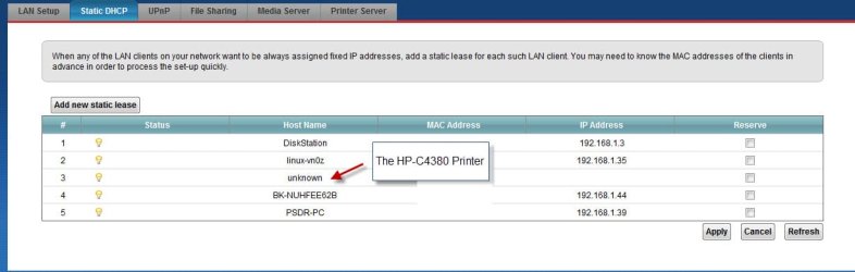

Here there is a shot from my router showing the printer.
As can bee viewed, ther IP has not been found.
Due to security I deleted the MAC addresses on the shot :D

The screenshot is here.
