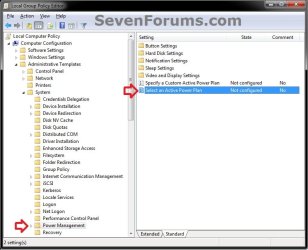

2. In the left pane, double click/tap on the arrow to expand Computer Configuration, Administrative Templates, System, then click/tap on Power Management. (see screenshot below) GPEDIT-1.jpg
3. In the right pane, double click/tap on Select an Active Power Plan. (see screenshot above)

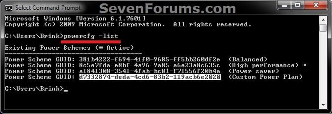

NOTE: If you wanted to specify a default power plan, then using either OPTION ONE or OPTION TWO above instead would be an easier way to do so. 1. Open a command prompt, type powercfg -list, press Enter, and make note of the long GUID number of the custom power plan that you previously created. (see screenshot below) custom-1.jpg

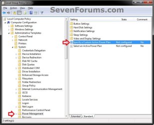

2. Open the Local Group Policy Editor.
3. In the left pane, double click/tap on the arrow to expand Computer Configuration, Administrative Templates, System, then click/tap on Power Management. (see screenshot below) custom-2.jpg
4. In the right pane, double click/tap on Specify a Custom Active Power Plan. (see screenshot above)

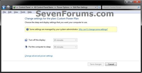

6. To Specify All Users to have a Custom Power Plan A) Select (dot) Enabled, and type in the long GUID number (step 1) for the name of the custom power plan that you wanted to specify under the Custom Active Power Plan (GUID) options section. (see screenshot below step 8)
B) Go to step 7.
7. Click/tap on OK. (see screenshot below) custom-3.jpg

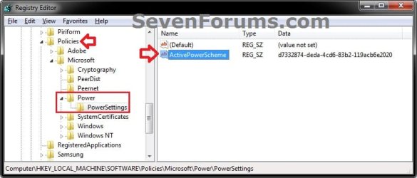

4. To Specify All Users to have a Custom Power Plan A) In regedit, navigate to the location below. (see screenshot below) HKEY_LOCAL_MACHINE\SOFTWARE\Policies\Microsoft
B) In the left pane of regedit, right click on the Microsoft key, click/tap on New and Key, type in Power, and press Enter. (see screenshot below step 4A)
NOTE: If you already have the Power key in the left pane, then skip this step and continue to step 4C instead.
C) In the left pane of regedit, right click on the Power key, click/tap on New and Key, type in PowerSettings, and press Enter. (see screenshot below step 4A)
NOTE: If you already have the PowerSettings key in the left pane, then skip this step and continue to step 4D instead.

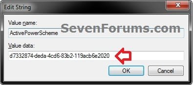

D) In the right pane of PowerSettings, right click on a empty space, click/tap on New and String Value, type in ActivePowerScheme, and press Enter. (see screenshot below step 4A)
NOTE: If you already have the ActivePowerScheme string value in the right pane, then skip this step and continue to step 4E instead.
E) In the right pane of PowerSettings, double click/tap on ActivePowerScheme to modify it. (see screenshot below step 4A)
F) Type in the long GUID number (step 1) for the name of the custom power plan that you wanted to specify, and click/tap on OK. (see screenshot below) custom-5.jpg

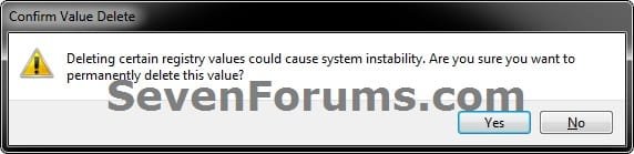

B) In the right pane of PowerSettings, right click on ActivePowerScheme, and click/tap on Delete. (see screenshot below step 5A)
C) Click/tap on Yes to confirm deletion. (see screenshot below) custom-6.jpg

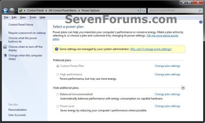

hi, how do you change the preferred plans above?
mine currently set to balance and power saver
if can, i want to remove balance profile and make high performance and power saver as my preferred plan

No i dont mean remove the balance, i just want to let the balance in the hide plan, and performance plan into the preferred plan
Like the first example picture, because I frequently switch to power save and performance most of the time, and i dont use balance plan

I'm not sure you can change the order of how the plans are listed in Power Options since it's based on what you currently have selected.
Since you toggle between power plans often, you might see if adding the context menu from the tutorial below may make this easier for you.
