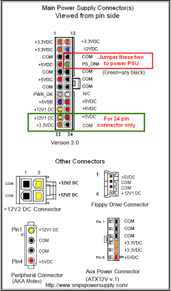

I have been struggling with a new build and got to PSU testing.
Here's how to test yours if suspect. Press the latch on the side of the main connector and wiggle it out of its socket. The PSU won't power on unless the main connector is attached to the motherboard or you jumper the main connector as shown below. The common thing to use is a paper clip bent in a "U" shape and can be inserted in either side of the plastic connector.
DO NOT JUMPER ANY CONDUCTORS OTHER THAN GREEN AND BLACK.
There will be one green wire, jumper it to any black one. This will allow the PSU to power up and its fan will run. If it has an on/off switch confirm it is ON. If the EPS 12V 4/8 pin is connected to the motherboard your CPU fan may run.
It is a better test if you use a digital multimeter after you have the PSU running to check actual volts output at the pins. Touch the "-" lead to any black wire pin then the "+" to each of the other colored pins and take a reading. They should be ±5% of listed voltages.
The diagrams below show the current ATX configurations in use.

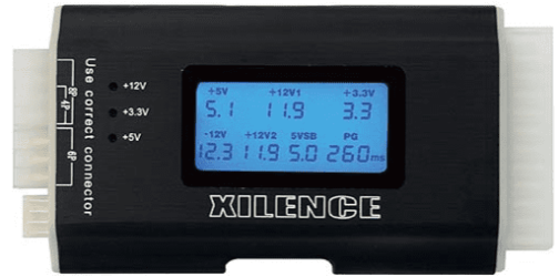

You should always ensure that you use a digital multimeter to measure the voltages. An analogue one can be used, however due to its low resistance when compared to a digital model, a true reading will not be obtained. For the best results, testing should be carried out under normal load conditions. Testers are available which can apply an artificial load, and which simply plug into the relevant cables. An example of such a tester is shown below:
These should be available from Amazon, NewEgg, or any good computer hardware stockist.
