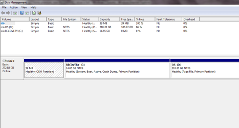

Can you post up a screenshot of your maximized Disk management drive map and listings, using the Snipping Tool in Start Menu?
Type DIsk Management in Start Search box, open it and maximize.
Create a Rectangular Snip and attach in reply using Paper Clip. We can help you better this way.

Got It!
There's a 2nd picture

Sorry it took a while to write back. Greg seems to busy at the moment, and I am currently try to help a couple other people with there issues. Your page file is currently on your D drive, so it will have to be turned off first. Open the start menu, right-click Computer and click properties. From there, click advanced system settings. The window that open should already be in the advenced tab. Click settings under performance, go to the advanced tab in that window and click change under Virtual Memory. Uncheck the box at the top and then select no paging file. After that you should be able to follow the steps in the links below, but I seem to recall extending the partition your current OS is on as impossible to do within Windows 7. If that is the case Greg should be able to help or I can try to find the relevent information for doing this myself.

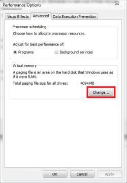

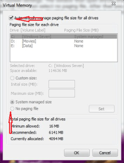

Here's some screenshots to go with Petey's instructions,

Hi Lauren -
Petey is exactly right about the need for deleting the page file on D so you can delete D and extend C into its space. Derek has provided you screenshots to make it even easier.
