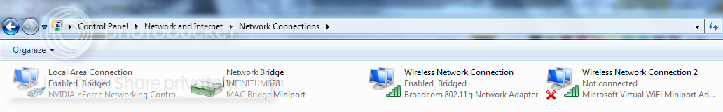

Ok, so I've been searching how to get this to work but it doesn't
I want to be able to get to Live through my laptops wifi, connecting the xbox via ethernet to my computer
I know i have to bridge the LAN and the wireless network connection but it doesnt work :sick: the "allow other network users to connect through this comp internet..." option is disabled in both
my pc is running the windows 7 RC 7100

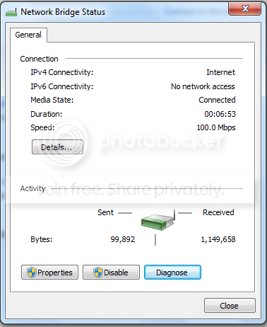

here is the status of the bridge connection when the xbox is plugged to my computer
clearly it says that does not have internet access, but i don't know how to solve that
hope you guys can help me, if you need any detail, let me know

hey man, thanks for the tip
but it didn't work for me =\
this comes up on the active networks window
don't they have to be part of the same network to work?

EDIT: Okay try doing that, and have an Ethernet cable plugged into your laptop and run it to your 360, it should work. Mine shows it as the same too but I'm on XBL right now.
EDIT 2: Okay so it works fine even though it says 'no internet access', all you really need to do is just turn your Xbox 360 on, try connecting to XBL and it SHOULD work. :)

it looks like my lan does not have access to the internet
like if the wireless does not share with LAN
when I click the LAN to see it's properties, it says No internet access
in both IPv4 connectivity and IPv6
when my Wireless shows that it has internet access in the IPv4
i don't know whats the problem here

well, even your LAN says " no internet access", you still connect to xbox live if you follow one of the above method. good luck...

In windows yes, it will say there is no internet access. Have you actually tried connecting to XBL with your 360 regardless though?

yes, connecting through my xbox account and doing the "test connection"
but it does not go online :( :( this is frustrating x
