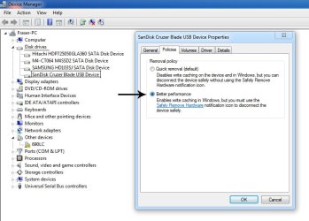

Hi, I may be wrong but 'quick removal' may be enabled.
Try disabling it.
By opening device manager. (Start, search run and run this "devmgmt.msc") make sure you run as admin if it asks.
Find your drive in the menu. (Mine is a usb memory stick but it may apply to your drive.)
Click 'disk drives' > find your drive in the submenu (mine was a sandisk memory stick) > double click the drive > select the 'policies tab' > check better performance > click 'apply'
Reboot. See if that worked. If not sorry it's all i can suggest.

thanks for your help. Unfortunately that didn't help. Very odd situation this....if I figure it out I will post back but anyone reading this have any idea? Thanks!
