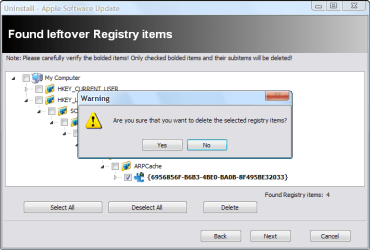

I know nothing about that program, but if you can, try installing it again. Then, remove it using Revo Uninstaller free: Download Revo Uninstaller Freeware - Free and Full Download - Uninstall software, remove programs, solve uninstall problems. Find the program in Revo, click uninstall, then click advanced, and follow the tutorial. When the registry picture (posted) pops up, make sure all the registry boxes are checked (only the registry boxes, not the folders). Then delete them and click next. If a page full of folders pops up, select them all and delete them as well:
After that, run this scan: http://www.sevenforums.com/tutorials/1538-sfc-scannow-command-system-file-checker.html
