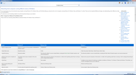

Click Start>Help & Support then type Workgroup Setup in the Search field for loads of useful information for setting up a Workgroup.
