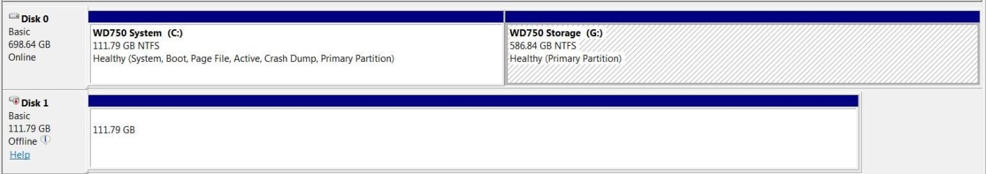

Just tried it with the OS booted up on the HDD and now it shows the SSD as being offline. Here is screen shot of what it looks like.

Make sure the files are accessible booting the Win7 DVD, try copying some to SSD now.
Copy & Paste - in Windows Recovery Console
Can you rightclick on the Disk Management pane which says Offline to bring it Online?
You can also use Diskpart to bring it online:
1. Open an elevated command prompt:
2. type diskpart. (this will switch to the DISKPART prompt)
3. at the DISKPART prompt, type list disk.
4. Make note of the disk number of the missing or offline disk
(offline disks are numbered 0, 1, 2, etc..)
(Missing disks are numbered M0, M1, M2, etc..)
5. At the DISKPART prompt, type select disk and disknumber and then enter.
example: select disk 0 and enter.
6. You should see "Disk ... is now the selected disk.
7. now type online and enter.

Make sure you get everything off the OS partition first using the DVD/CD method I gave you.
I'd also try to bring the HD back online in Disk Mgmt or using Diskpart first as it may be all it needs, unless you got further information that there is a conflict of some sort which needs resolving first.
I deleted the system partition and tried rebooting into the SSD, but it still shows the HDD as being offline. Which command do I use in diskpart to try and bring the HDD online? Oh, no problem with getting the data off the storage partition as I have an older PC with Windows XP and the HDD shows up as being online on that machine.

There is an "online" command available.
Enter /help in diskpart to see the full list of commands.

Does marking the drive as "online" with diskpart fail?

I've never used that command, but did you select the disk before using the command?
I'm also wondering about the "rescan" command in diskpart.

Yes, I was able to select the disk in diskpart, but it wouldn't accept any of the commands, because it was offline. Maybe I wasn't doing it right. Anyway, I had a WinPE disk with Easesus Todo Workstation and was able to use the recover to dissimilar hardware feature to restore an old Win XP image to the partition that had Win 7 installed on it previously. I then hooked it back up to my new PC and it now comes online, with both partitions intact. Not sure how it worked, but am happy with the result. Thanks you guys for your input. As always it is appreciated!
