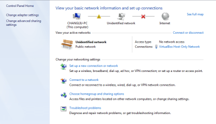

First, please forgive me with my poor English.I have very common problem that my internet didn't work. I have no router.My network show me "no network access" as the belowing screenshoot , Can you teach me how to fix it?

first thing you can do is click on yellow triangle (from your image) in network and sharing center to start troubleshooter.

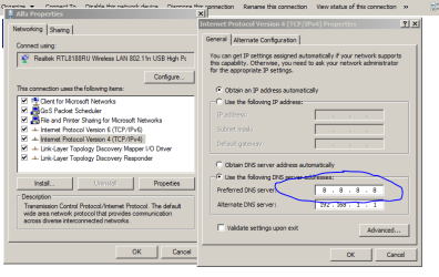

also if still no response try setting your network adapter under Control Panel\Network and Internet\Network Connections >> right click adapter >> properties >> Internet protocol 4 (IPv4) with folowing settings from this image:

Thx, I have already fix that problem and I want to ask another question that why still there is a unidentified network show up

Hi again,
I'm glad you set your net..
from your output it looks you are using a virtual machine? (Oracle VM VirtualBox, Windows vitual PC, WMWare etc..)
so this Unidentified network is network between your comp and virtual machine :)
to set ip up you'll have to play with VM options.
cheers!
