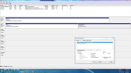

Please boot into Win7 with both HD's attached and post back a screenshot of your maximized Disk Management drive map with listings, using the Snipping Tool in Start Menu: Screen Shots
You can copy any remaining data you need from HD into SSD or externally via Explorer now, correct?
So are you ready now to recover the System boot files into SSD and wipe the HD?
Window pics
Here are the disk manager and superimposed msconfig boot tab windows.
Does this help?

Currently the SSD's boot files reside on the HD as shown by it holding the System label. To correct this mark C Active: Partition - Mark as Active
Then power down to unplug the HD, boot into BIOS setup to set the SSD first to boot. Then run Startup Repair - Run 3 Separate Times until Win7 starts and C holds the System Active boot flags.
You can then plug back in the HD to access it's data or even boot it using the one-time BIOS Boot Menu key. If a Dual Boot menu persists, delete D listing in msconfig>Boot.

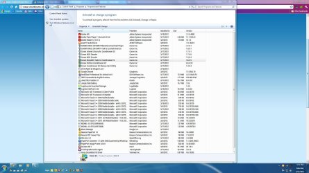

Here is a screenshot of my uninstall menu from the SSD. The programs without space listed in "Size" were installed from my SSD Win7 instance, but onto the HDD under a folder called "Programs installed from SSD". They are taking no space on the SSD. And they require HDD activity to run. I use them less frequently.
The other programs do not activate the HDD, since they run purely off the SSD - faster and quieter.
