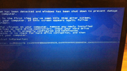

Ok, I decided that the BSOD that is flickering when my computer restarts during startup each time was probably pretty important. I was able to record my screen while it occurred and then pulled a screenshot of the BSOD out of the video. Here's the best quality picture I could get.
I did a quick google search for the 0x0000007b part of the error and the first link said that it's pretty indicative of a driver issue, which makes sense since the last thing I did before having all these issues was install some additional network and chipset drivers 9as explained in the original post). But I really don't know what else to do with this information. Is there someone who can look at this and maybe tell me exactly what these errors mean? Or at least the ones that be made out.

Try System Restore again from System Recovery Options.
Test your RAM: RAM - Test with Memtest86+. Remove the RAM sticks and check that their slots are clean of debris, try starting with one stick, then the other, swap sticks.
Test your HD with maker's HD Diagnostic extended CD scan, followed by another Disk Check from Recovery Options Command line.
Reset the CMOS: Clear CMOS - 3 Ways to Clear the CMOS - Reset BIOS . Check the SATA controller setting in BIOS. Set SATA controller to AHCI to try starting and then reinstall after copying out your files using methods given. Clean Reinstall - Factory OEM Windows 7
System restore didn't work. Also, I think I forgot to mention that I have a very old Vista installation also on this HD that boots up fine. That's the OS that I'm mostly using until I can get the 7 one back up and running. So I'm pretty sure my RAM is working fine. Hard drive tests came up clean.
Is a reinstall my only option at this point? I think it might boot normally if I could just uninstall the extra chipset and Ethernet drivers I installed for the other computer. But I have no idea how to do that without booting up the OS they're installed on.

I told you in the beginning that Win7 would have to be readjusted to boot it after changing the hardware. It was only luck that you got it to boot on the new hardware, and now it must be adjusted again for it to have any chance to boot on the original hardware.
What were the results of running Paragon Adaptive Restore CD on the Win7 installation? This is how you adjust the drivers, HID, SID and activation to move to another computer - it's a combination of these which most often will stop it from starting on changed hardware.
