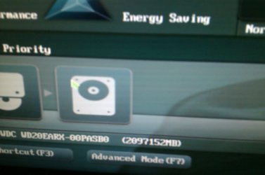

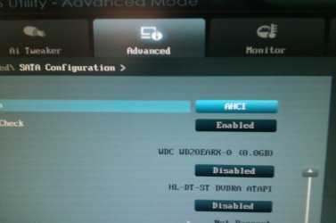

here are the screen shots.
Windows 7 64 bitCore i5-2500k4GB * 2 DDR3
Windows 7 64 bit
Core i5-2500k
Asus P8Z77-M
4GB * 2 DDR3
WD 2 TB Green
450 watt
First image shows 2TB hard disk. second one in advanced mode shows 0 MB for same. I don't understand how this can happen. I set all CSM filters as Legacy only.

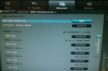

hot plug is disabled.

looks like Hard disk was faulty. am getting new one tomorrow.

got a new hard disk. everything is working fine. thanks for all the support :)
