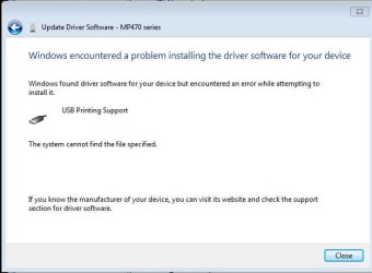

I am unable to install the printer portion of the driver on my newly built PC.
The scanner portion works shows up in Devices and Printers not the printer.
I downloaded and installed successfully the drivers from Canon.
When i turn on the printer Windows tries to install it but its says "it failed'
Device Manger pick up and recognizes my printer > It puts it under "Other Devices" > "MP 470 Series" with an exclamation mark > I double click and get this under "General":
"The drivers for this device are not installed. (Code 28)
The system cannot find the file specified.
To find a driver for this device, click Update Driver."
When I try to do an update on the driver automatically I receive the error (attached it with a screenshot):
"Windows encountered a problem installing the driver software for your device.
Windows found driver software for your device but encountered an error while attempting to install it.
USB Printing Support

To be honest sounds like your printer is buggered,
Test it these ways, Try installing on another PC. Use a different USB port.
Or Try this.
UN INSTALL all printer software and Drivers, Run CCleaner and fix registry, restart computer, GOGO services and CHECK that Spooler is running. Turn on printer and plug into computer. WAIT.

Already tried that:
like i said it already works on my Win 7 laptop.
it still doesn't work on my PC even if using a diff. USB port
I did have all printer stuff removed, ran the cleaner, spooler working > still won't finish the install.
I forgot to mention that i also did this:
Start menu, devices and printers, and click add printer.
1. Chose " Add a local printer" > "use an existing port" > chose "virtual USB port".
2. Click windows update which found the Canon Inkjet MP470 driver printer driver > it installs it but when I try to print the Canon is one of my options of printers to select from and then i get a "printer not Responding" message ( I attached a screen shot)
It will show in Devices and Printers, and if I try to print a test page same error.
... same exclamation mark and missing drivers details in Device Manager.

- it's x64 bit drivers.
- it's USB000...
- i can't change to USB001 because it is not available on the list of ports
- about connecting, I am on my way out anyway, but suggestions are more then welcomed and maybe we can do the remote session at a later time.

Just copy "usbprint.sys " and "usbscan.sys" respectively to %SystemRoot%\Windows\inf and also in %SystemRoot%\Windows\System32\driver.
I fight one week to find it out this solution with the same PC Asus as yours trying to install drivers for a printer Canon MP495.
All is gone well after this manipulations as incredible it was?!?...
Good luck !
