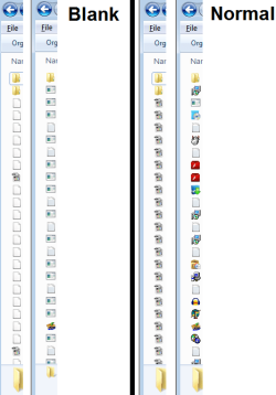

After some time on the computer the icons become blank and My Computer doesn't load.
It all returns to normal after I end the task "dllhost.exe", and after some time the problem comes back again.

I've managed to pin point what exactly is causing the problem inside the dllhost.exe process with the help of Process Explorer (by Sysinternals) and its listing of Handles inside each process.
When the problem happened I went into the list of Handles inside dllhost.exe and started closing handles one by one to see after which one the problem disappears.
It turns out to be something called "ALPC Port/RPC Control" (Screenshot attached)
I really hope this info will help in figuring out this annoying problem.

Apparently it has something to do with Acronis True Image:
After some searching, this is what I've done:
1. Logged out of the Sync in Acronis ([DUPLICATE] Slow folder display issues possibly caused by Acronis True Image 2013? | Knowledge Base) [I already had "Acronis Nonstop Backup Service" and "Acronis Sync Agent Service" stopped and set to manual, and so I started "Acronis Sync Agent Service", logged out of Sync and stopped the service. Left "Acronis Scheduler2 Service" on and set to Automatic]
2. Renamed ti_manager_proxy_1.dll (Com Surrogate failure | Knowledge Base)
Now I have dllhost.exe running but the problem doesn't happen. Hopes it stays this way.
If not, apparently it only happens with Acronis 2013, so I'll install the 2012 or 2011 version.
Edit: this solved it.
