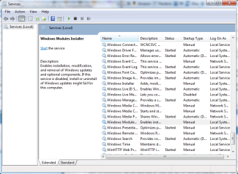

I've started having various problems cropping up for a couple month now.. Among them being:
Periodic, random de-selection of the current active window, rendering it seemingly unresponsive to input until clicked on again.
"The Windows Security Center service can't be started."
"windows Update cannot currently check for updates, because the service is not running. You may need to restart your computer." Upon looking for fixes, I noticed that I don't even HAVE the windows update service anymore.

I've tried running the 'sfc /scannow' thing, and it supposedly fixed everything it could, however nothing changed noticeably.

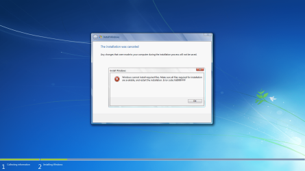

Problem
See attachment..
I tried using some microsoft fixit thing a couple times, but it never could do anything at all..

Alright. Progress report.
I tried it a different way, booting from the disc and formatting my HD from there before installing from the disc..
That was the only way it worked, else it gave me errors and said a file that was in the recovery drive (D:) was corrupted and unreadable, and thus refused to let me proceed.
